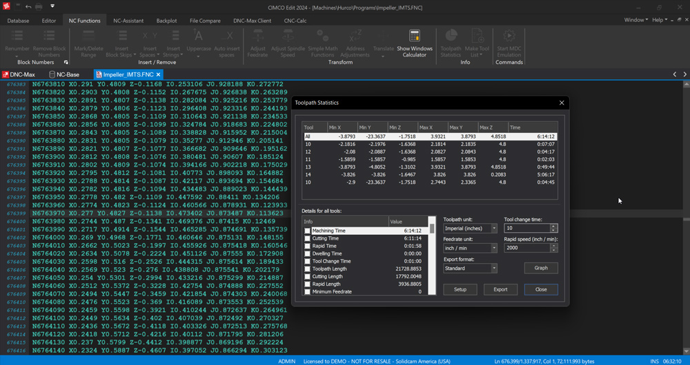

SolidShop Editor
A powerful CNC editor able to manipulate NC code and automate programming tasks
  • Simulate parametric code using solid models and watch program variables changing values during the execution
  • Compare files, program canned or complex probing cycles and parametric code through the editor macros with just a few clicks
  • Apply mathematical transformations to G-code (mirror, rotation, scaling, plane transposals, basic math operations, handle angle heads, etc.)
  • Convert proven G-code from one CNC type to another (e.g., Heidenhain to ISO or FANUC to Siemens, etc.)
  • Gain the ability to simulate canned & parametric cycles for turning (Roughing, threading, drilling), milling (Pocketing, drilling, engraving), probing, block skips, and conditional logic used by the mainstream CNC controls

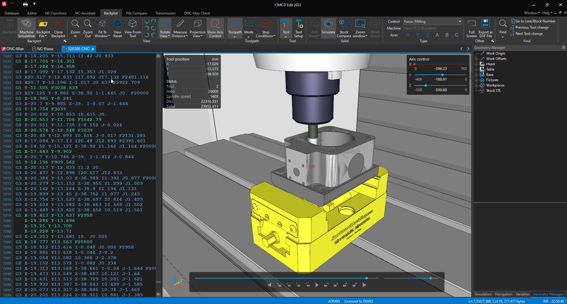

G-code Machine Simulator
An add-on for the SolidShop Editor that enables you to verify your G-code for CNC machines from 2 to 5 axes, and lathes equipped with a C axis and a turret
  • Detects collisions between machine elements and axis overtravel, allowing work envelope studies and offline training on the programming aspects of the machine, as well as static and dynamic stock sectioning
  • Rigorous and configurable syntax checker that enables you to deliver verified code to the CNC machine
  • When used with SolidShop DNC, provides bi-directional protection for your processes and machines
  • Lightning fast material removal simulation

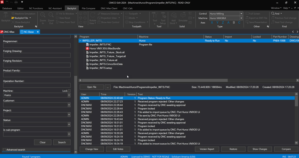

SolidShop PDM
Our manufacturing-oriented Product Data Management module delivers one of the most important steps towards shop floor digitization. Fully integrated into SolidShop Editor, SolidShop PDM manages all types of documents in a centralized database accessible to anyone in the company, through a desktop application or web clients.
  • 100% oriented to manufacturing and shop floor staff
  • Single source of truth (SSOT) for all CAM, CMM, CNC files, sub-programs, setup sheets, tool lists, quotations, drawings, CAD models, e-mails, catalogs, and anything else that must be centralized
  • Eliminates hard copies and out-of-revision documents
  • Efficiently manage programs, sub-programs, and their parent/child relationships with other programs. In conjunction with the SolidShop DNC, one click is enough to send main programs and linked sub-programs directly to the CNC machines, all at once
  • Advanced access controls to manage precisely what and who can perform tasks
  • All interactions with the system and documents or programs are tracked and traceable
  • Ideal solution for highly regulated industries looking for robust change and access controls for sensitive manufacturing data, especially when industrial cyber security is becoming critical
  • Supports ISO 9001, AS9100, API, and other standards
  • Tightly integrated with SolidCAM and SolidCAM for Operators - An end-to-end paperless solution
  • Control backups and revisions in SolidCAM files, NC programs and documents in general. Rollback changes with a few clicks & implement design revisions without overwriting files permanently

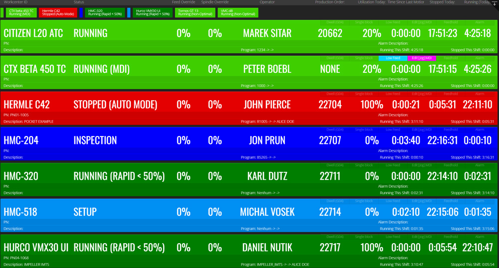

SolidShop Machine Monitoring
A real-time machine monitoring solution with interface to ERP, FMS systems, Power BI, Graphana, SQL databases (Read/Write), TCP connections & pure text-based protocols. It supports integration with other systems to read/write & manage production order information and execution status, turning SolidShop PDM and SolidShop Machine Monitoring into an MES solution.

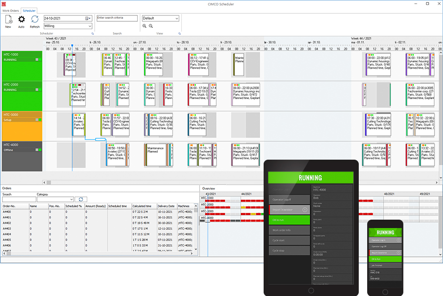

SolidShop Planner
Advanced module for production planners to determine when to start production to deliver on time (Backward planning), find slots in upcoming days, weeks, or months to schedule, track in real-time production orders and keep the machines loaded with work (Forward planning).
