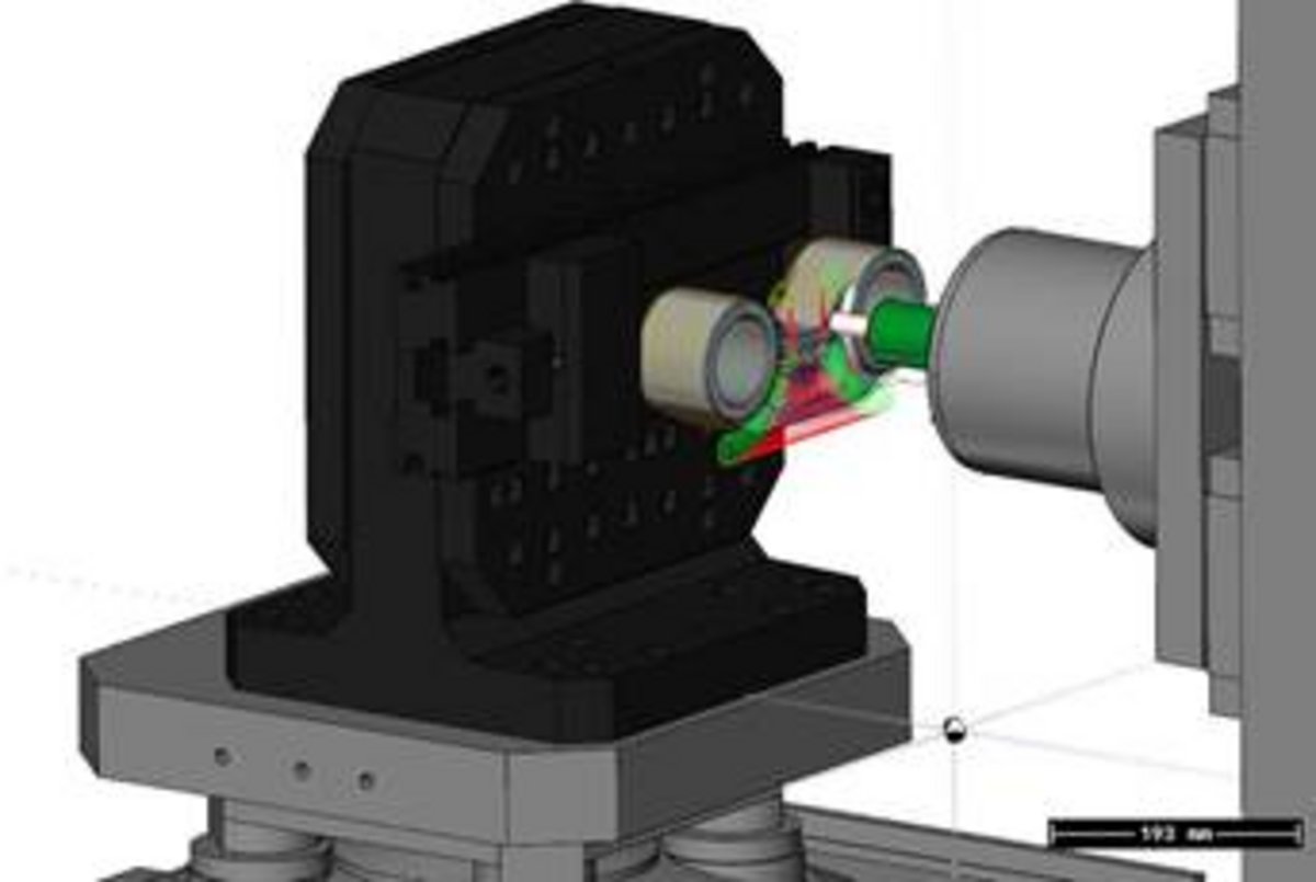

CAM SYSTEMS demonstrated the wide facilities of SolidCAM, in support of machines with complex architecture, and tested iMachining technology on a customer part and machine tool.
CNC Machine: Horizontal Machining Center DAHLIH MCH-800 with 18.5 kW Spindle Power
Material: constructional steel (C45, Gv=650 mPa)
Depth of Cut: 23.5 mm
Tool: End Mill | Diameter 16 | Guhring
Previous Cutting Time: 14 minutes
iMachining Cutting Parameters: Level 4
iMachining Cutting Time: 6 minutes
iMachining Savings: 57% Cycle Time Reduction
